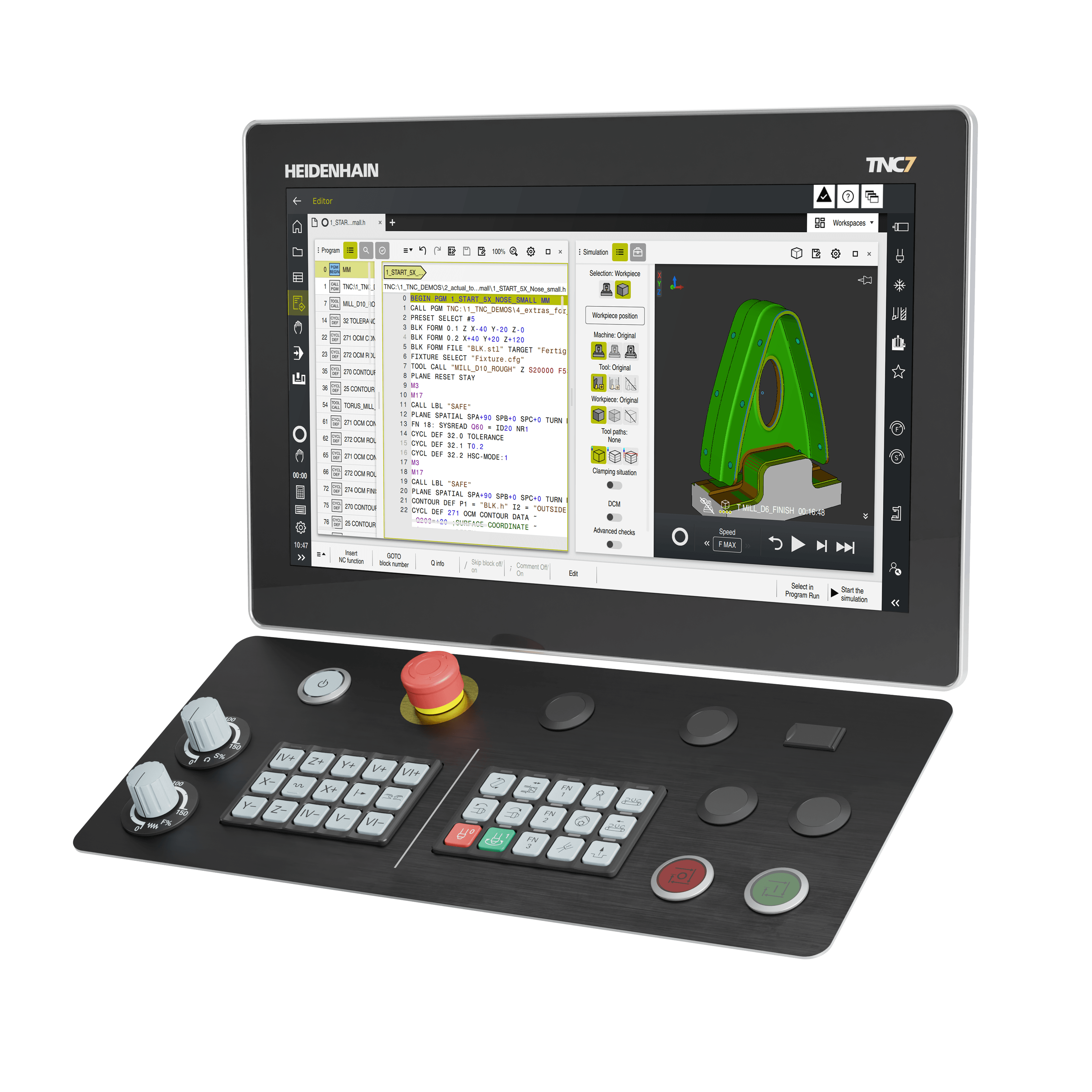

TNC7 basic contouring control
Compact, intuitive and powerful
  • 8 control loops, up to two of which are for spindles
  • Highly responsive operation and smooth, intuitive touch operation
  • Extensive smart probing and machining cycles
  • Graphically guided workpiece and fixture setup
  • High surface quality with short machining times
  • Fast block-processing time (0.5 ms)
  • Successor to the TNC 620
Customizable operating interface
Users of the TNC7 basic enjoy optimal support for whatever their work calls for, including NC progrmaming, machine setup and part inspection. The screen of the TNC7 basic can also be customized, allowing users to arrange functions and information exactly as needed. The control's Dark Mode enhances user experience in low lighting conditions.
Versatile installation
The TNC7 offers exceptional user-friendliness in a compact form factor. Combinable with a full-size keyboard or a machine operating panel, the TNC7 hardware is adaptable to a variety of machine designs. High-quality components ensure fast responsivness and smooth touch control, contributing to an outstanding user experience.
Optimized motion control
The Advanced Dynamic Prediction (ADP) function provides motion control optimization. ADP dynamically precalculates the contour, adapting the machine's movements based on a jerk-smoothing acceleration limit. As a result, perfect surfaces are can be attained even with a highly variable point distribution.
Intelligent programming
The TNC7 basic adds smart functions to the familiar HEIDENHAIN Klartex programming language. New graphical programming functionality lets users draw contours directly on the touchscreen. Final contours are translated into and stored as Klartext code. It's also an easy way to modify existing programs.
Fast and accurate machining
The Dynamic Precision and Dynamic Efficiency software packages provide many high-performance functions for even more efficient and accurate TNC7 machining. They're a fast and dependable way to achieve perfect parts by applying high-efficiency machining strategies, optimized motion control, jerk reduction and more.
Predictive protection
Protect your machine from damage while preventing downtime. The Dynamic Collision Monitoring (DCM) function monitors the machine envelope across all operating modes and stops machine movements in response to potential crashes. Further protection is provided by targeted component monitoring that detects spindle wear and overload before it's too late.
