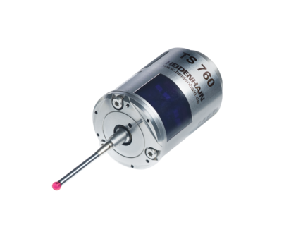

TS 760
- Signal transmission: radio and infrared
- Interfaces: HTL or EnDat 2.2 (via transciever)
- Probing speed of up to 1 m/min
- Dust-proof and water-resistant
