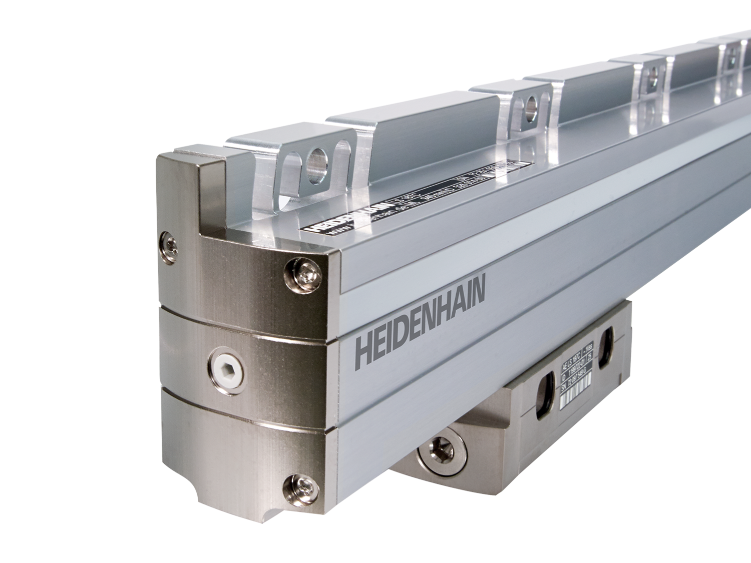

LS 100 series
Incremental linear encoders with full-size scale housing
  • For linear axes up to 3040 mm long
  • Accurate and reliable position measurement
  • Rugged design
  • Interfaces: 1 VPP and TTL
Reliable protection
The proven seal design of the LS 100 provides optimal protection from chips, dust, and coolant. Due to the diagonal orientation of the sealing lips and the scanning unit's sword, the encoder can be mounted either upright or on its side.
Easy installation
Sealed linear encoders from HEIDENHAIN are very installer-friendly. As guided systems, they provide wide mounting tolerances for fast and easy installation.
High vibration tolerance
Linear encoders with a full-size scale housing feature long measuring lengths, high ruggedness, and superb vibration tolerance. As a result, the LS 100 series thrives even in harsh environments.
