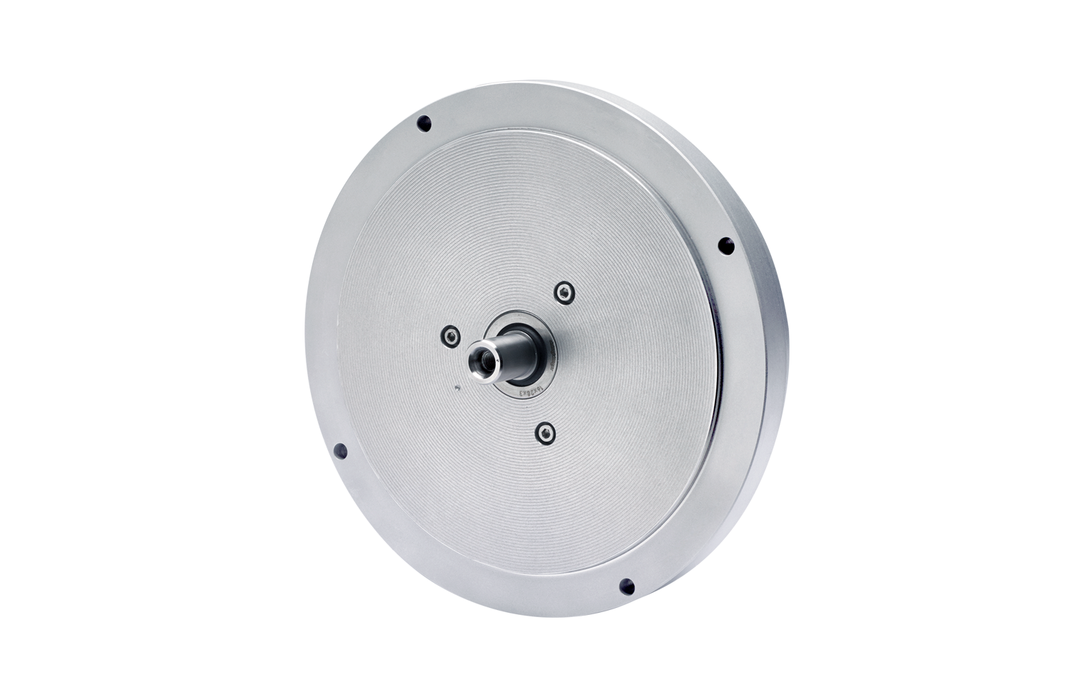

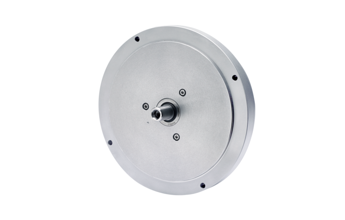

ROD 780 and ROD 880
Incremental angle encoders with high system accuracy
  • System accuracy of ±1” / ±2”
  • For separate shaft coupling
  • Solid shaft with ∅ 14 mm
  • Signal periods per revolution: 18 000 / 36 000
  • Interface: 1 VPP
Wide mounting tolerances
The solid shaft of the ROD 780 and ROD 880 angle encoders is connected to the measured shaft via a separate coupling and permits axial tolerances of up to ±1 mm.
High accuracy
Based on a high line count of up to 36,000 lines, the angle encoders of the ROD 780 and ROD 880 series transmit sinusoidal output signals.
